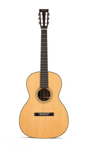

Is this what we're talking about? If so close is fine with me. As long as it fits in the proper case and has this appearance. I mean, I'll end up tweaking the details anyway. Certainly if it's got the old Martin spec sheet and supervisors notes, that's a bonus.

That really is a classic, in the broader sense of the word.
